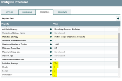

Then you can use Merge content processor with defragment as merge strategy and change the below properties
Delimiter Strategy
Text
Header
Footer
Demarcator
In this processor we are again merging all the individual json messages into one json array with comma as demarcator.
