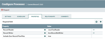

I apologize, I forgot that you are talking about an Avro format and not json. In this I think you need to pass your own avro schema. You can first convert Avro to Json using ConvertAvroToJSON processor , then use ConvertRecrod which can be configured as follows:

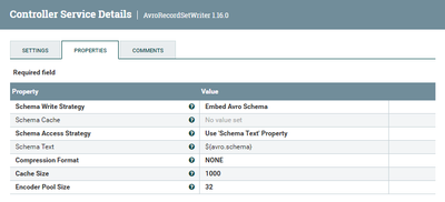

In the AvroRecordWrite , you can set your schema with the proper record\namespace values. For Example in my case I used the "User Schema Text" strategy and either provide the schema directly in the Schema Text Property or reference it using flowfile attribute ${avro.schema} using Expression Language.
The Schema Text :
	"type": "record",
	"name": "bank",
	"namespace": "org.xyz.com",
	"fields": [
			"name": "AGENT_CODE",
			"type": [
				"null",
				"string"
			"name": "CORR_ACC_NO",
			"type": [
				"null",
				"string"
			"name": "LOCAL_ACC_NO",
			"type": [
				"null",
				"string"
Hope that helps
