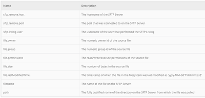

Master Mentor
@Justee
ListSFTP only generate a FlowFile with attributes/metadata about the file on the SFTP processor.  It does not look at the content itself.  So your filtering options are limited to what is in those generated attributes.
The FetchSFTP processor uses these attributes/metadata to retrieve the actual content and add it to the existing FlowFile produced by the ListSFTP processor.
So unfortunately you would need to fetch the all files and then keep on those that contain the desired value in the third field.  You may want to look at the RouteText [1] processor for handling these Files after they are the content is fetched.
