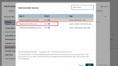

I am facing an issue with Notify and Wait starting from version 2.0.0. In order for them to listen to each other in version 1.28, I need to configure them with the MapCacheClientService 2.0.0 and MapCacheServer 2.0.0 services. However, in version 2.0.0, although I can still find both services in the documentation, in practice, the configuration only includes the MapCacheClientService 2.0.0 service, and I can no longer find the MapCacheServer 2.0.0 service.
Using Wait and Notify in version 2.0.0 seems much more difficult compared to previous versions. I spent two days trying to figure it out, but I haven't made any progress. If possible, could you please guide me on the correct configuration so that Wait and Notify can work properly, like they did in the older versions?

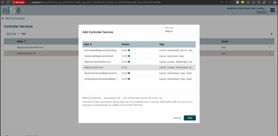

@SAMSAL MapCacheClientService provides the ability to communicate with a MapCacheServer. I can find MapCacheServer in Add Controller Service
It seems like I have found a solution to my issue.
Thank you
Thank you
