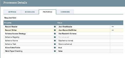

Hi,
i need to ingest only the JSON files following a valid schema.
i am trying to achieve this by validate-record processor.
i am supplying the same schema for both JSONTreeReader and JSONRecsetWriter.
I am not using AVRO because my input contains _ in the names.
(but i came up with this schema by modifying the input file without _ and using inferAvroSchema and then changed both to use _ to match the input file)
my schema and files are matching but its sending it to invalid relation. Anything wrong that i am doing..??

I'm not sure what you meant about changing the "-" to "_" with InferAvroSchema and such, but here's a different approach (assuming you have HDF 3.1 / Apache NiFi 1.5.0+) so you can use the "correct" Avro schema even though the field names have Avro-invalid characters:
Create an AvroSchemaRegistry controller service, and add a property called "mySchema" or whatever you want to call it, with the original schema as the value. Then set the "Validate Field Names" property to false (this was added in NiFi 1.5.0 via NIFI-4612), this will allow field names such as "general-1" without throwing an error. Then in your JsonTreeReader you can have an access strategy of "Use Schema Name", specifying your AvroSchemaRegistry in the "Schema Registry" property and "mySchema" as the value for the "Schema Name" property. The JSON writer can Inherit Schema so you don't need to put the schema in there either. When the schema comes from the schema registry with Validate Field Names set to false, you can use it even when the field names are not Avro-valid.
