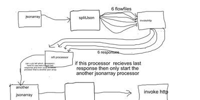

drawing-1.jpegHi, I have a requirement to to wait one processor upto another processor complets its task
1.Let say I have a json array ,which contains the 6 json objects, i am splitting the json array so then i have 6 flowfiles
2.These 6 flowfiles one by one sending to the invokeHttp processor and get the 6 responses .Here i need to check the last response if its success then i need to start the another processor
3.I have attached the diagram representation ,please find.
In Nifiprocessor box which one i should use.Could you please provide the solution ?
Thanks

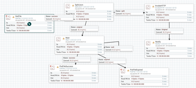

Why not use the wait and notify processor?
Redirect the original file to wait processor from the splitJson processor.
In the wait processor set the Target Signal Count to ${fragment.count}.
Set the Release Signal Identifier in both the notify and wait processor to ${fragment.identifier}
Now start the flow. The SplitJson will split the flow file and redirect the original flow file to the wait processor. It will wait there until the target signal count i.e in this case fragment.count number of fragements have been notified by the notify processor.
Please try to construct a flow like below
Hope this helps
