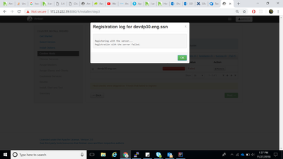

I am still not very clear regarding the FQDN of the system needed while registering the host.
The screenshot is attached.

Hi @Shraddha Singh,
From the screenshot its not evident what error you are facing.
Can you go click on the hostname and see what error its showing.
also Have you followed the pre-requisites to prepare all the nodes?

Created 11-27-2018 06:24 AM
I have manually nstalled the agent and made the changes in .ini file of ambari-agent and restarted everything but still I am getting the error that
Registration with the server failed.
I have changes the server name of .ini file as the output of hostname -f command.

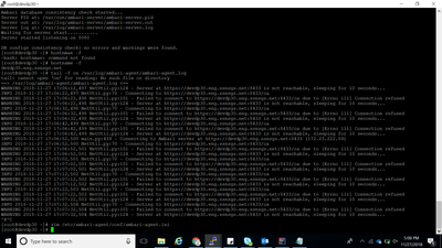

Created 11-27-2018 06:30 AM
Hi @Shraddha Singh,
Can you do a tail -f on /var/log/ambari-agent/ambari-agent.log
[root@asnaik-script-amariadb1 ~]# tail -f /var/log/ambari-agent/ambari-agent.log INFO 2018-11-27 06:30:05,217 logger.py:75 - Testing the JVM's JCE policy to see it if supports an unlimited key length. INFO 2018-11-27 06:30:05,490 Hardware.py:176 - Some mount points were ignored: /, /dev, /dev/shm, /run, /sys/fs/cgroup, /run/user/0 INFO 2018-11-27 06:30:05,494 Controller.py:320 - Sending Heartbeat (id = 1279793) INFO 2018-11-27 06:30:05,499 Controller.py:333 - Heartbeat response received (id = 1279794) INFO 2018-11-27 06:30:05,499 Controller.py:342 - Heartbeat interval is 1 seconds INFO 2018-11-27 06:30:05,499 Controller.py:380 - Updating configurations from heartbeat INFO 2018-11-27 06:30:05,499 Controller.py:389 - Adding cancel/execution commands INFO 2018-11-27 06:30:05,500 Controller.py:406 - Adding recovery commands INFO 2018-11-27 06:30:05,500 Controller.py:475 - Waiting 0.9 for next heartbeat INFO 2018-11-27 06:30:06,401 Controller.py:482 - Wait for next heartbeat over
and see if you can find these in ambari-agent log
if ambari-agent is able to send heartbeat to ambari-server then we should see
tail -f /var/log/ambari-server/ambari-server.log
and see what exception or error you are finding when you press rety.

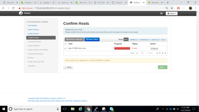

Created on 11-27-2018 11:46 AM - edited 08-17-2019 04:08 PM
The output of the command is attached: 8433 as i changed the url port to 8433,it is still not reachable
Created 11-27-2018 02:56 PM
I got the following result after running the command:
WARNING 2018-11-27 13:42:59,507 NetUtil.py:124 - Server at https://devdp30.eng.s sn:8440 is not reachable, sleeping for 10 seconds... INFO 2018-11-27 13:43:09,507 NetUtil.py:70 - Connecting to https://devdp30.eng.ssn:8440/ca ERROR 2018-11-27 13:43:09,509 NetUtil.py:96 - EOF occurred in violation of protocol (_ssl.c:618) ERROR 2018-11-27 13:43:09,509 NetUtil.py:97 - SSLError: Failed to connect. Please check openssl library versions. Refer to: https://bugzilla.redhat.com/show_bug.cgi?id=1022468 for more details. WARNING 2018-11-27 13:43:09,509 NetUtil.py:124 - Server at https://devdp30.eng.ssn:8440 is not reachable, sleeping for 10 seconds... INFO 2018-11-27 13:43:19,510 main.py:439 - Connecting to Ambari server at https://devdp30.eng.ssn:8440 (172.23.222.59) INFO 2018-11-27 13:43:19,510 NetUtil.py:70 - Connecting to https://devdp30.eng.ssn:8440/ca ERROR 2018-11-27 13:43:19,511 NetUtil.py:96 - EOF occurred in violation of protocol (_ssl.c:618) ERROR 2018-11-27 13:43:19,511 NetUtil.py:97 - SSLError: Failed to connect. Please check openssl library versions. Refer to: https://bugzilla.redhat.com/show_bug.cgi?id=1022468 for more details. WARNING 2018-11-27 13:43:19,511 NetUtil.py:124 - Server at https://devdp30.eng.ssn:8440 is not reachable, sleeping for 10 seconds... INFO 2018-11-27 13:43:29,512 NetUtil.py:70 - Connecting to https://devdp30.eng.ssn:8440/ca ERROR 2018-11-27 13:43:29,513 NetUtil.py:96 - EOF occurred in violation of protocol (_ssl.c:618) ERROR 2018-11-27 13:43:29,513 NetUtil.py:97 - SSLError: Failed to connect. Please check openssl library versions. Refer to: https://bugzilla.redhat.com/show_bug.cgi?id=1022468 for more details. WARNING 2018-11-27 13:43:29,514 NetUtil.py:124 - Server at https://devdp30.eng.ssn:8440 is not reachable, sleeping for 10 seconds...
