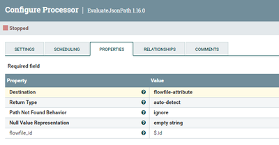

To get the id attribute you can use EvaluateJsonPath as follows:
The flowfile_id is dynamic property where the value is the json path to the id of the json input. Make sure to set the Destination property to "flowfile-attribute".
