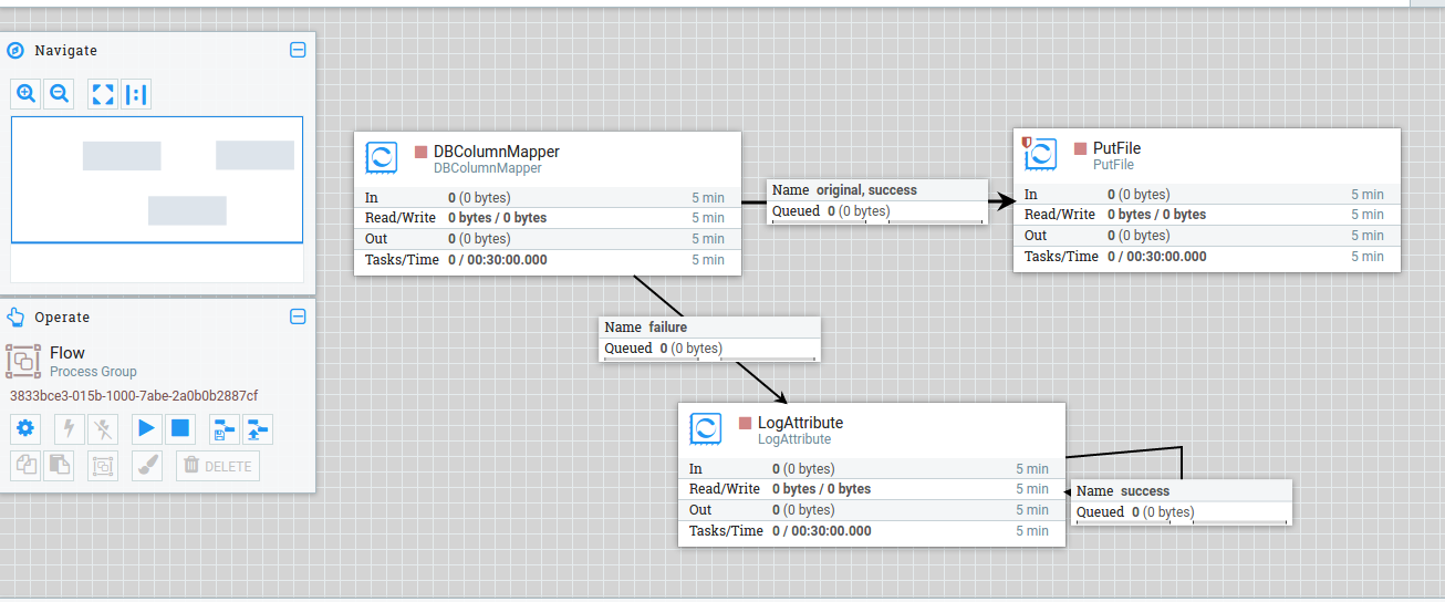

Following is my workflow template.png and my configuration of custom processor dbcolumnmapper-configuration.png

The error "is not the most recent version of this FlowFile within this session" means that somewhere in your processor you transferred a FlowFile reference, but that reference is no longer the most recent version of the FlowFile.
Here is an example that would produce this error:
FlowFile flowFile = session.get();
session.putAttribute(flowFile, "key", "value");
session.transfer(flowFile, MY_RELATIONSHIP);
Because the result of session.putAttribute was not assigned back to flowFile, the transfer here is trying to transfer the reference from line 1 which is no longer the latest reference. The code should be:
flowFile = session.putAttribute(flowFile, "key", "value");
Thanks @Bryan Bende , it worked for me. Now i am getting the following error after the line session.commit() in the following code ontriggermethod.txt -------
DBColumnMapper[id=43376208-015b-1000-8176-8a62b92462aa] DBColumnMapper[id=43376208-015b-1000-8176-8a62b92462aa] failed to process due to org.apache.nifi.processor.exception.FlowFileHandlingException: StandardFlowFileRecord[uuid=357d0770-3aea-4def-b607-e93f574593ea,claim=StandardContentClaim [resourceClaim=StandardResourceClaim[id=1491495241588-2, container=default, section=2], offset=10858, length=496],offset=0,name=187456790845166,size=496] transfer relationship not specified; rolling back session: org.apache.nifi.processor.exception.FlowFileHandlingException: StandardFlowFileRecord[uuid=357d0770-3aea-4def-b607-e93f574593ea,claim=StandardContentClaim [resourceClaim=StandardResourceClaim[id=1491495241588-2, container=default, section=2], offset=10858, length=496],offset=0,name=187456790845166,size=496] transfer relationship not specified....
Thanks in Advance.
This means somewhere you created a flow file, or obtained on from the session, and the flow file was never transferred to a relationship or removed. Every flow file either needs to be sent somewhere via session.transfer() or needs to be deleted via session.remove().
