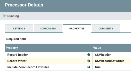

ConvertRecord:

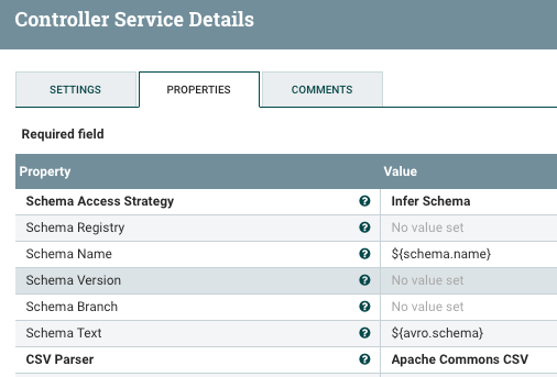

CSVReader:

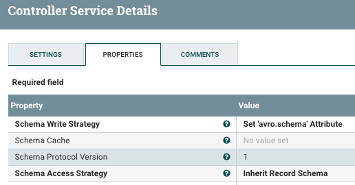

CSVRecordSetWriter:
