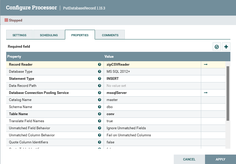

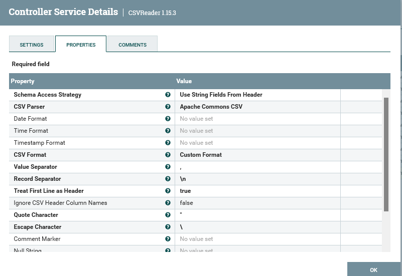

I have many zip files each containing a csv file. The header of the csv file contain fields and some field names have space between words e.g "field one" instead of "field_one" which is the one in the database.
Please, what is the optima method to change the csv field names to match the ones in the database.
NOTE: I am using MSSQL as the DB. And my NIFI implementation is
1) GetFile : from a repository that contain zip files of very large size
2)UnpackContent: to extract the csv from the zipped file
3) PutDabaseRecord: to persist the csv data into db because of its large size.
Thank you for your kind help.

You can use a QueryRecord processor before the PutDatabaseRecord.
You can add a relation to the QueryRecord processor with the following associated query:
select
"field one" as field_one,
"field two" as field_two,
"field three" as field_three
from flowfile
 In the query above you can reference one field names using double-quotes if they have spaces. You can specify an alias for that column, which is the field name that will be used in the output.
