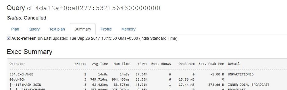

Created 09-26-2017 12:46 AM
have seen the execution summary ,its taking 15 mins and after that query is getting cancelled.have already done compute stats for involved tables. there is no memory problem as it shows consumption 340 MB out of 35 GB of memory.
