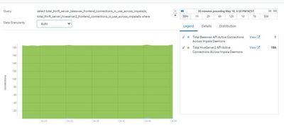

I am facing an issue with one of our Impala Daemon which continuously has error related to “The health test result for IMPALAD_FRONTEND_CONNECTIONS has become bad: There are 0 (Beeswax pool) 123 (Hive Server 2 pool) active client connections, each pool has a configured maximum of 128”
Have checked CM -> Impala -> Charts Library -> check "Active Frontend API connection" this shows too many Hive Server connections
Also checked server's network side and run netstat -an | grep ESTABLISHED | grep 25000 but I see only 2 active connections.
