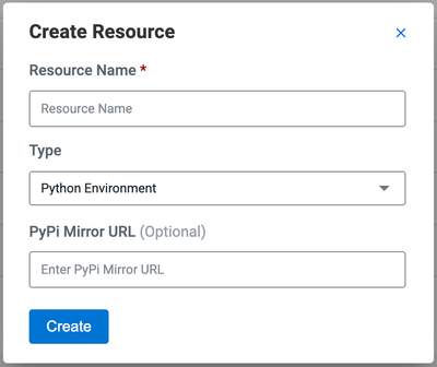

How did you create the resource?
As a File Resource or as a Python Environment?
Here are the steps how you can create it:
https://docs.cloudera.com/data-engineering/1.5.4/use-resources/topics/cde-create-python-virtual-env....

Explorer
I create a resource as a file, because the python-env resources are specifically for managing Python packages in requirements.txt, according to the documentation.
