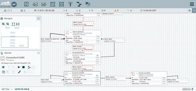

I'm taking raw pipe-delimited text files, converting them to Avro and then converting them to ORC files (because ORC files are awesome), and everything is working swimmingly, except the conversion from Avro to ORC is extremely slow, which is causing my processing to back up infinitely.
Is there a better method to convert raw text into an ORC file in NiFi or some kind of efficiency that can be gained to allow the data to flow through much faster?
