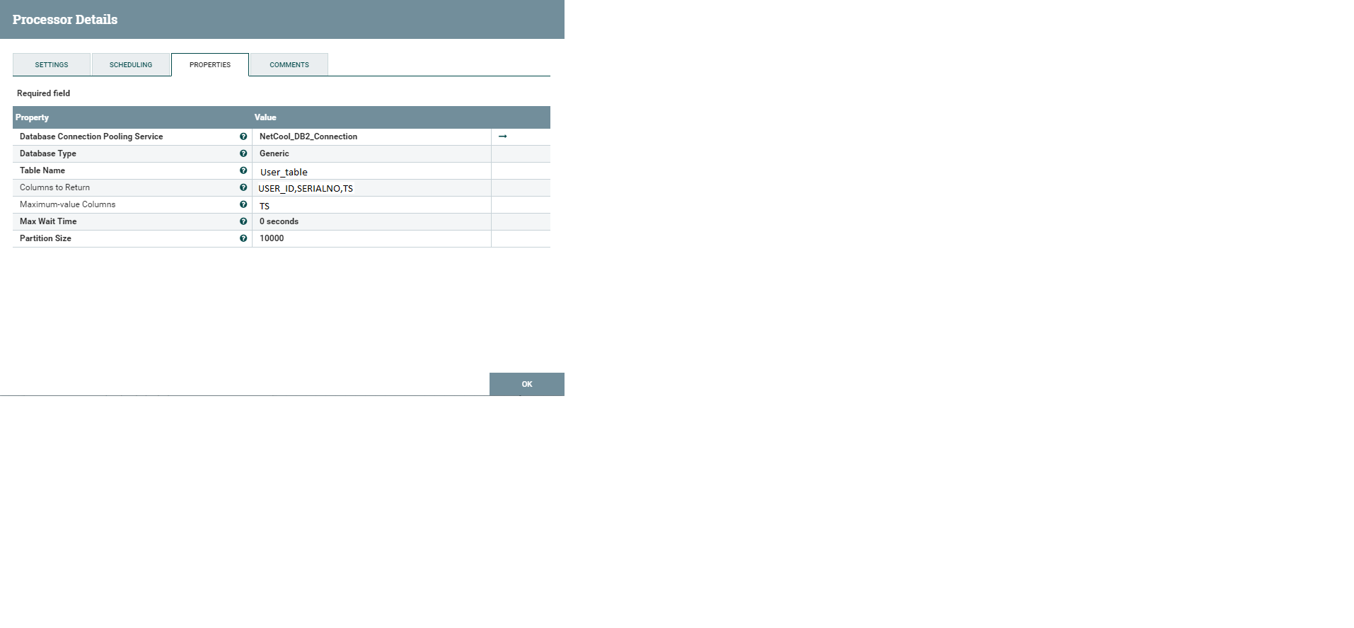

I have 3 columns , Userid , Serial no and Timestamp column(YYYY-DD-MM HH:MM:SS) in DB2 . I would like to create a incremental load using Nifi . userid,serialno are random numbers not increased primary numbers . TS is increamental.
I have tried to use
FLOW 1
QueryFetchTable->ExecuteSQL->PutHIveStreaming --> logattribute (to avoid duplicates)-- Not working , No Error in the logs (refer attached pic for configuration ) nf.pngnf1.pngnf2.png I'm not able to load even single data to hive using this method as I have used max_column is TS . -- Hive table is Partitioned , Bucketed , ORC and transantional

Flow 1 is the right one, what errors are you seeing?

@Matt Burgess Is that QueryDatabasetable or GeneratetableFetch. Let's say I have 100 records in my source table(DB2) . When I add one record in my source I should be getting 101 records ,instead i get around 201 records . I get duplicated records and keep on adding duplicates for every new record @Shu or @Matt Burgess Kindly assist . Im missing a small thing . Kindly clarify.nf11.png Refer attached for the flow .

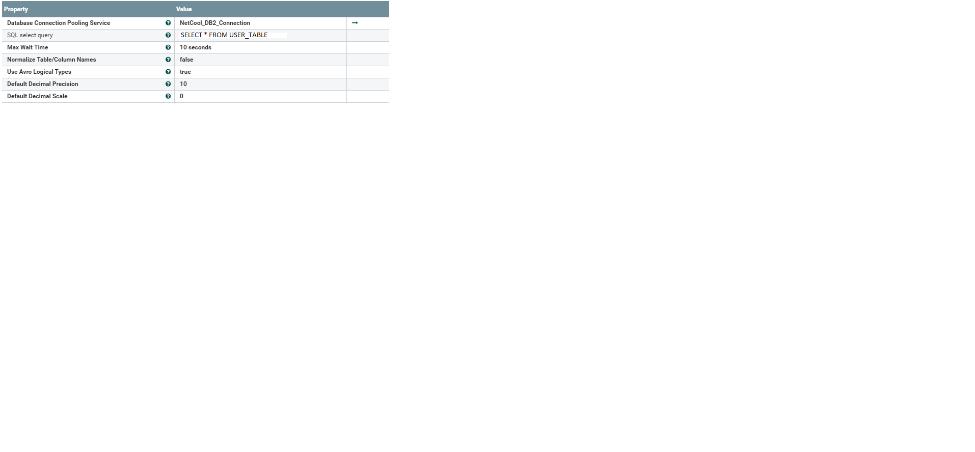

nififlow.png , Attached the working flow with configurations . Everything is working except duplicates . Kindly assist
Super Guru
Your ExecuteSQL appears to have a query specified in the "SQL select query" property. This means it will ignore the contents of the flow files, which are each SQL statements themselves. Clear the "SQL select query" value, and then ExecuteSQL will use the flow file contents to execute those statements, which should have the SQL for incremental fetches.
