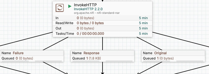

Here is an example configuration using a secured Apache NiFi 2 instance to retrieve the NiFi system diagnostics data from the NiFi rest-api of the same Nif where the dataflow is running.

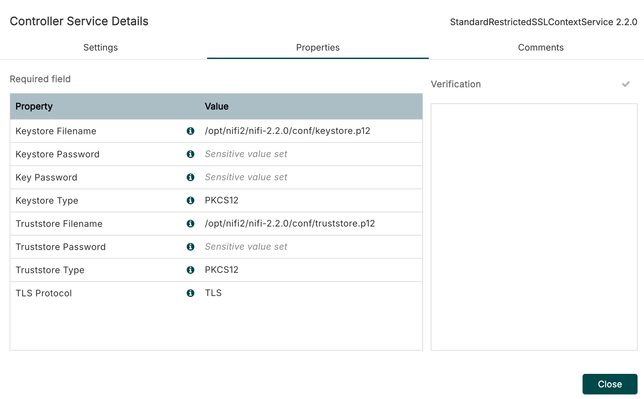

  • Since NiFi is secured, the rest-api endpoint will require authentication and authorization.  The easiest way to set this up is to use a clientAuth certificate keystore for authentication.  So I setup a StandardRestrictedSSLContextService within the NiFi Process Group.MattWho_0-1764785452590.png

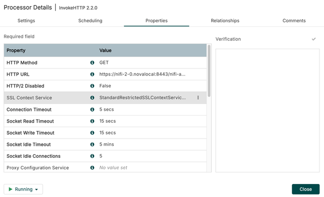

  • I then configured my InvokeHTTP processor to use the above SSL Context service and configured the appropriate rest-api endpoint for the system diagnostics (https://<nifi-hostname>:<nifi-port>/nifi-api/system-diagnostics)MattWho_1-1764785580514.png

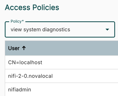

  • Next I need to make sure my clientAuth certificate DN user identity has been authorized for the "view system diagnostics" within the NiFi Policies; otherwise , you will encounter a 401 not authorized response:

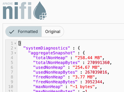

  • Now when my invokeHTTP executes I get the json response from that rest-api endpoint with my diagnostic data:MattWho_3-1764785992172.pngMattWho_4-1764786064853.png
