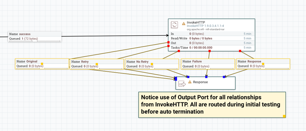

A good NiFi developer will build a flow during development where all bottom branches are visible, including routing all processor relationships, even ones that will eventually be auto terminated.   This gives visibility during testing and flow creation if someone unexpected happens.  I use stopped output ports for this purpose.
