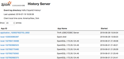

Check in spark history server ui to see which applications are run in local mode:
In above image you can see local-* are applications launched in local mode and application_* are applications launched in yarn master.
If you like to switch the default local to yarn, perhaps you can add export MASTER=yarn on the spark-env so that users that forget to add --master yarn will by default run in yarn master.
