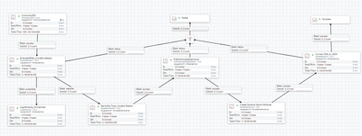

My processor is as follow,

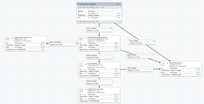

And for ProcessXMLStageDB,
ConsumeJMS connected to IBM MQ. Jar file and truststore file to connect with IBM MQ is included in the Nifi image, i.e. I create custom image to add the necessary requirement to connect to IBM MQ.

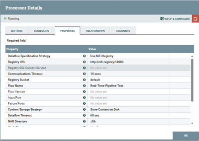

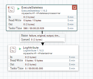

This is my ExecuteStateless,
This are the details of the executeStateless process,
When running i can see following error,
