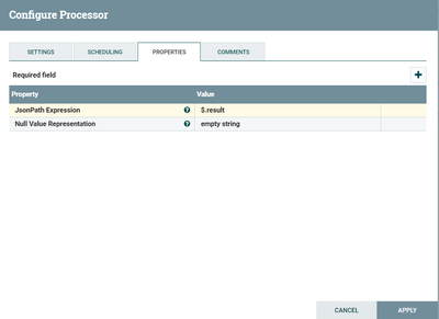

I need to get the sys_id into an attribute and have tried the following:
1. SplitJSON and EvaluateJSONPath but SplitJSON ends gets an EDT error based on the contents of the JSON.
1.1 SplitJSON
1.2 EvaluateJSONPath
2. Now I'm trying to cleanse the content in hopes I can just throw the one thing I need over to EvaluateJSONPath.  Currently having problems getting regex expression to function on flowfile to select all but one line and replace it with null.
Regex expression tried:  ^(?!.*sys_id).*$
