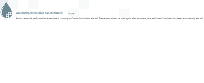

Hi, i have been experiencing some issues with my NiFi standalone. It starts with errors relating to leader election and of recent it just throws me out of the system completely. see the error message below;

Just got the error "An unexpected error has occurred. Action was performed, but no nodes are connected." while working with a flow. The flow simply takes log files and put in HDFS. NiFi went dead at the point of putting the files in HDFS. The file sizes are less than 150MB and there are only 24 of them.
I have restarted the cluster and it's back up...
