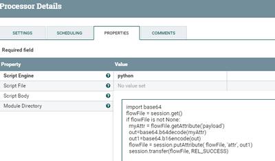

Use the below script to add the encoded payload attribute to the flow file.
Script:-
import base64 flowFile = session.get() if flowFile is not None: myAttr = flowFile.getAttribute('payload') out=base64.b64decode(myAttr) out1=base64.b16encode(out) flowFile = session.putAttribute( flowFile, 'attr', out1) session.transfer(flowFile, REL_SUCCESS)
diff between 'out1',out1
flowFile = session.putAttribute( flowFile, 'attr', 'out1') //script adds attribute attr value as out1(because out1 is in single quotes). if you want to add the out1 actual encoded value we need to use out1 without single quotes.
Here is an example i tried:-
i am having payload attribute value as asdf.
Python shell output:-
>>> import base64 >>> out=base64.b64decode('asdf') >>> out1=base64.b16encode(out) >>> print out1 6AC75F
NiFi Script:-
Output:-
As you can see above payload attribute value is asdf and script attr value is 6AC75F, Python shell output and script outputs are matching.
