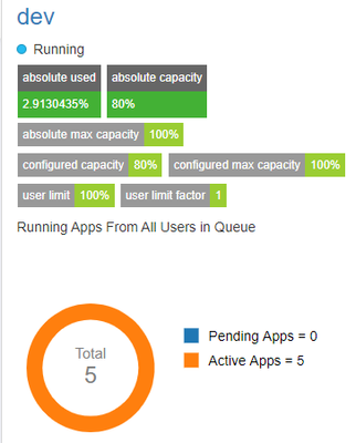

I am facing issue with resources for individual jobs in a queue.
My 'Dev' queue details =
How can I make sure that individual job can take unlimited resources in the particular queue?
For now I have increased resources from 30% to 80% for 'Dev' queue as 'Maximum user limit 100%' is not helping.

I also observed that the queue is unable to use available resources from other queues when the resources are available.
Anybody facing issue issue?
Let's say 'Dev' queue has weightage of 30% with 100% capacity enabled.
The queue max reaches 40% capacity even if more resources are available in other queues.
