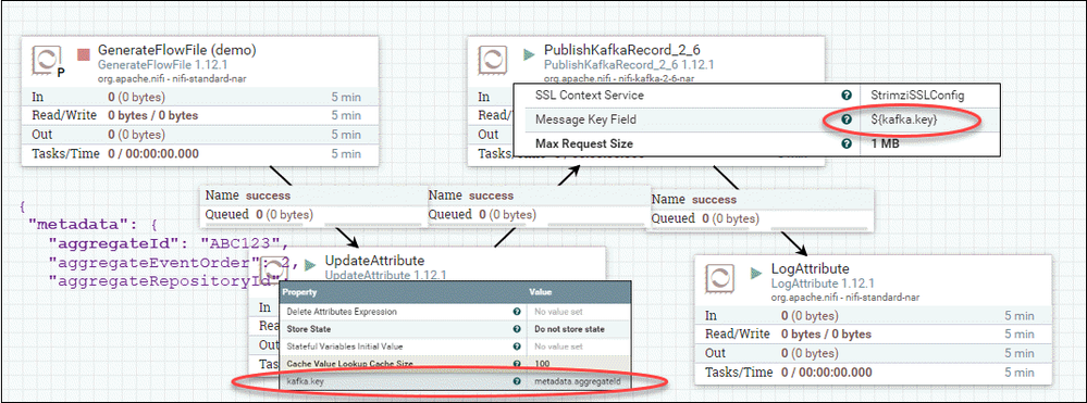

I am using PublishKafkaRecord to produce Kafka messages from the incoming Json data.   The json data has the right field to be used as the key to the Kafka message but the kafka key is not populated.   Here's what I did (using Nifi 1.12.1).
1. `GenerateFlowFile` produces a record with the future kafka key (i.e. 'metadata.aggregateId' field)
2. Used `UpdateAttribute` processor to add an attribute called 'kafka.key' with 'metadata.aggregateId' as its value
3. `PublishKafkaRecord` has its `Message Key Field` as ${kafka.key}
4. Produced Kafka message key is null
5. `LogAttribute` shows all necessary hooks are there
And, here's the application log:

What am I missing here?  @sdairs 's explanation was helpful in stackoverflow but did not work for me.

@CloudNaive ,
It seems that the "Message Key Field" property doesn't work with a nested structure. This property must refer to a top level field of the record that contains the key value.
In the example below I used UpdateRecord to create a top level field called "id" and update it with the value of "metadata.aggregateId". Them, on the PublishKafkaRecord I was able to use the "id" field as the Kafka message key.
