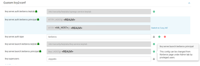

Also on the Ambari UI, we have the following configuration for the service spark(Livy2)
And in the Kerberos we have the following config:
My understanding is that the value in the service spark(Livy2) conf
livy.server.launch.kerberos.principal livy/_HOST@<REALM>
is replaced by the value set in the Kerberos page
livy.server.launch.kerberos.principal ${livy2-env/livy2_user}/_HOST@${realm}

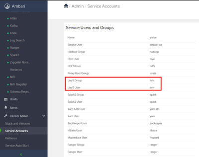

What is the value of livy2-env? Where can i get this info?
For livy2_user the value is livy according to the param set in ambari:
