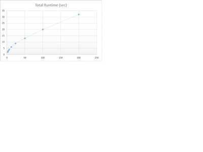

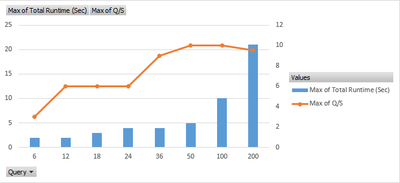

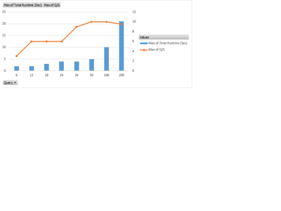

Thanks for answering my original questions, but I have to revise my questions because of a coding issue. The new result is actually better. I list the original questions below for reference.
  • Now, if running 6 unique queries concurrently take 4 seconds, is it a wrong expectation to think 50 concurrent queries (of the 6 unique queries) will return much faster than 13 seconds assuming all setup is correct, no IO issue, and it is truly concurrent?
  • By default, the recommended concurrent queries is 4. (Why 4?)
  • Also, is it possible to find out memory usage of each query?
