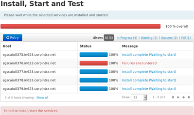

I'm trying to install a 5 node hadoop cluster with HDP 2.3.4.7 on Ubuntu 14.04 using Ambari 2.2.0.0. During the 10th step of the Ambari "Cluster Install Wizard" the installation of the ZooKeeper client fails on one of the five nodes with the following stderr:
"resource_management.core.exceptions.Fail: Applying Directory['/usr/hdp/current/zookeeper-client/conf'] failed, looped symbolic links found while resolving /usr/hdp/current/zookeeper-client/conf"
During the earlier steps of the "Cluster Install Wizard" and prior to this error, I removed the packages "zlibc" and "xclip" from two hosts, one of them now failing the ZooKeeper installation, in oder to comply with warnings telling me to do so. But "apt-get remove zlibc" and "apt-get remove xclip" also removed the Ambari agents on these hosts. Therefore the installation process didn't finish the first time because the heartbeat of these to hosts got lost during the installation. So I reinstalled the Ambari agents on these hosts but ever since I get the error mentioned above.
I hope someone can give me a hint or a solution. Thanks a lot.
