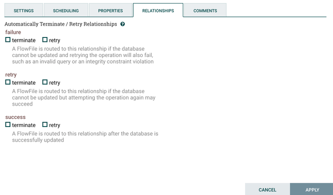

That is an interesting sequence of events on a single FlowFile (SEND followed by clones).  Can you share the "Relationships" configuration of your putSQL processor?
Make sure you have not checked the "retry" box on the "success" relationship.
Something you might want to try to see if same issue persists is to check the box for "retry"  on the retry relationship.   This allows the original FlowFile to remain in the inbound connection up to the configured number of retry attempts (default 10) before being routed to retry relationship.
I'd be curious of your observations post the above configuration change.
