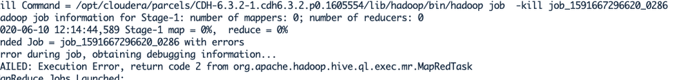

hi when I do some hive basic query like "select * from table" using Mapred execution engine, my job is failing with these kind of errors:
upon execution:

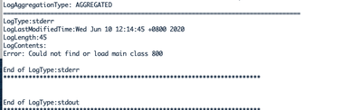

Yarn Logs: Error: could not find or load main class 800
RM logs: ==
USER=user OPERATION=Application Finished - Failed TARGET=RMAppManager RESULT=FAILURE DESCRIPTION=App failed with state: FAILED PERMISSIONS=Application application_1591667296620_0286 failed 2 times due to AM Container for appattempt_1591667296620_0286_000002 exited with exitCode: 1 Failing this attempt.Diagnostics: [2020-06-10 12:14:43.978]Exception from container-launch. Container id: container_1591667296620_0286_02_000001 Exit code: 1 [2020-06-10 12:14:43.979]Container exited with a non-zero exit code 1. Error file: prelaunch.err. Last 4096 bytes of prelaunch.err : Last 4096 bytes of stderr : Error: Could not find or load main class 800 [2020-06-10 12:14:43.981]Container exited with a non-zero exit code 1. Error file: prelaunch.err. Last 4096 bytes of prelaunch.err : Last 4096 bytes of stderr : Error: Could not find or load main class 800 For more detailed output, check the application tracking page: https://clouderacluster:8088/cluster/app/application_1591667296620_0286 Then click on links to logs of each attempt. . Failing the application. APPID=application_1591667296620_0286

@Mondi I have not seen this specific 800 error. You should be able to find deeper information in the actual application logs. They are hard to find, several clicks deep in the Yarn UI. Depending on your application, there can be many log files, and you will need to inspect each one for deeper details in the failure.
