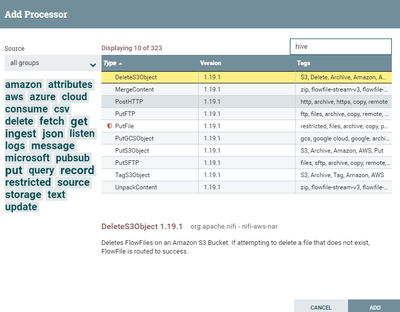

I downloaded the latest Nifi version. i was able to connect nifi to an oracle database and it works fine. However, i need to connect nifi to hive, my problem is i cant find any processors related to hive. There is no SelectHiveQL processor and no PutHiveQL processor or any processor related to hive at all. not even the controller services for hive is found.
Am I doing anything wrong? I just need to connect Nifi to hive and i can't find the processors responsible for this.

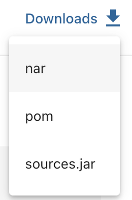

4. From the nar specific page you will see a "Downloads" option in the upper right corner of the page:
5. When you click on it three option appear.  Select "nar".

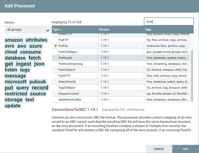

Now  you will see the Hive components available in your NiFi UI:

I can now see hive processors
