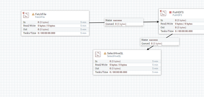

Below is my data flow:

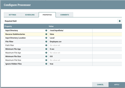

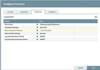

I have added ListFile and FetchFile processors in my flow but they are not fetching the file.

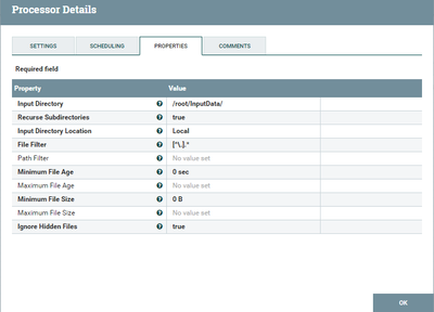

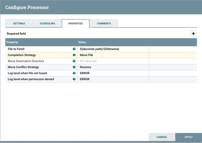

Below are the configuration for both of the files:
ListFile:

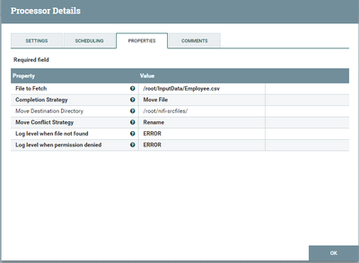

FetchFile:
There is no errors or warnings in Nifi Log.
@Muhammad Umar
If you only want to pull that one file, then just configure ListFile this way
then configure FetchFile this way
It will get the one file and move it.

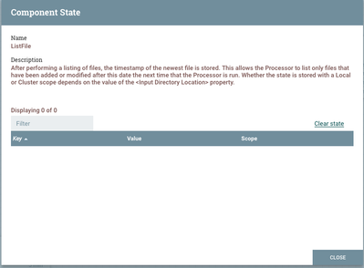

What you want to do is to clear the state of the processor.
Right click on the ListFile processor, from the menu that pops up, select View state
Then you will see a new window, in the middle right side of the window is a link Clear state, click that and the file will be picked up again the next time you want to pull it, and there you go.
