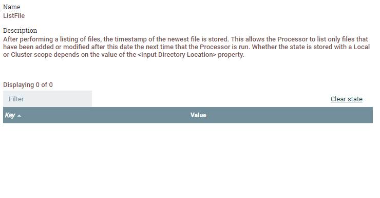

There is no error when I clear the state. When I click the "Clear State" link it removes the time-stamp etc entries below is the state after clearing:

So, the Clear state is working.
The warning you are seeing has nothing to do with the state of the processor.
