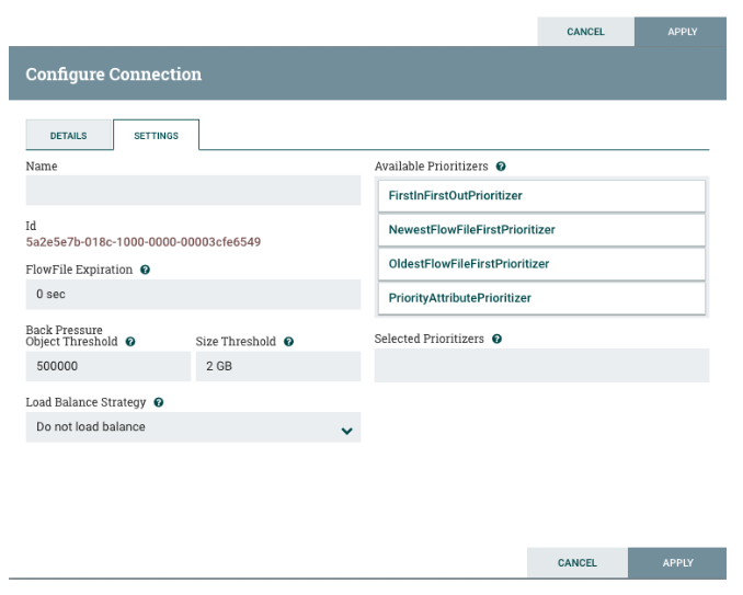

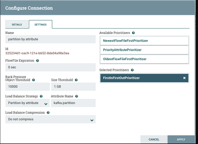

Upon examination, implementing the queue as a First In First Out prioritizer and configuring the load balancing strategy to Partition by attribute with the kafka.partition attribute has proven effective in maintaining the order.

Contributor
@MattWho
Thank you for your comprehensive response.
We are using NIFI cluster topology and only two processors ConsumeKafka and PublishKafka.
Our topics are configured with 36 partitions ,we have 12 nodes in our NIFI cluster, so we configured the concurrent tasks to 3 .
As mentioned, our topics are defined with cleanup police : compact, which requires a Kakfa key for each record. Can we use ConsumeKafkaRecord and PublishKafkaRecord when a Kafka key is involved?
Contributor
