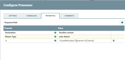

i have xml data like this below and i want to get localAttribtes tag by name 'rs' in my EvaluateXpath processor i tried this expression in my EvaluateXpath processor //localAttributes/*[@name='rs']/name() but i don't get "rs" tag value :

can you change the property to
//localAttributes[@name='rs']
it will gives you only

if name=rs is first in value every time in local attribute node then you can use
//localAttributes[1]
will results the same output.

yes it was helpful thank you
