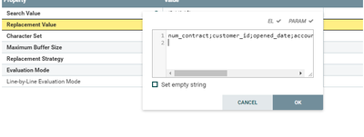

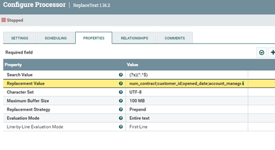

I am getting a csv without a header then adding a header with ReplaceText to it after the ReplaceText the header is added but the rest is crashed.
PS: This problem happen with this file only I tried the flow with other csv files and worked fine, can this be a csvReader problem or configuration on the encoding ?
Before :
The replace :
