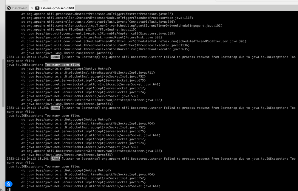

It looks like the high heap on the primary was caused by too many open files,Is there a way to identify the processor that open many files ?
We are using openjdk 17.0.7 ,nifi v 1.21.0 and custom processors .

2023-11-11 04:13:18,240 ERROR [Timer-Driven Process Thread-30] o.a.n.p.kafka.pubsub.PublishKafka_2_6 PublishKafka_2_6[id=c8d6883a-8b07-3d38-b28f-fc8263c83a39] Processing halted: yielding [1 sec]
java.lang.IllegalStateException: Cannot complete publishing to Kafka because Publisher Lease was already closed
        at org.apache.nifi.processors.kafka.pubsub.PublisherLease.complete(PublisherLease.java:476)
        at org.apache.nifi.processors.kafka.pubsub.PublishKafka_2_6.onTrigger(PublishKafka_2_6.java:490)
        at org.apache.nifi.processor.AbstractProcessor.onTrigger(AbstractProcessor.java:27)
        at org.apache.nifi.controller.StandardProcessorNode.onTrigger(StandardProcessorNode.java:1360)
        at org.apache.nifi.controller.tasks.ConnectableTask.invoke(ConnectableTask.java:246)
        at org.apache.nifi.controller.scheduling.TimerDrivenSchedulingAgent$1.run(TimerDrivenSchedulingAgent.java:102)
        at org.apache.nifi.engine.FlowEngine$2.run(FlowEngine.java:110)
        at java.base/java.util.concurrent.Executors$RunnableAdapter.call(Executors.java:539)
        at java.base/java.util.concurrent.FutureTask.runAndReset(FutureTask.java:305)
        at java.base/java.util.concurrent.ScheduledThreadPoolExecutor$ScheduledFutureTask.run(ScheduledThreadPoolExecutor.java:305)
        at java.base/java.util.concurrent.ThreadPoolExecutor.runWorker(ThreadPoolExecutor.java:1136)
        at java.base/java.util.concurrent.ThreadPoolExecutor$Worker.run(ThreadPoolExecutor.java:635)
        at java.base/java.lang.Thread.run(Thread.java:833)
2023-11-11 04:13:18,241 WARN [Timer-Driven Process Thread-30] o.a.n.controller.tasks.ConnectableTask Processing halted: uncaught exception in Component [PublishKafka_2_6[id=c8d6883a-8b07-3d38-b28f-fc8263c83a39]]
2023-11-11 04:13:18,247 ERROR [Listen to Bootstrap] org.apache.nifi.BootstrapListener Failed to process request from Bootstrap due to java.io.IOException: Too many open files
        at java.base/sun.nio.ch.Net.accept(Native Method)
        at java.base/sun.nio.ch.NioSocketImpl.timedAccept(NioSocketImpl.java:711)
        at java.base/sun.nio.ch.NioSocketImpl.accept(NioSocketImpl.java:752)
        at java.base/java.net.ServerSocket.implAccept(ServerSocket.java:675)
        at java.base/java.net.ServerSocket.platformImplAccept(ServerSocket.java:641)
