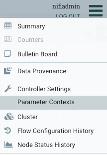

Please include screenshots showing following while authenticated as user having issues:
1. Actions attempting to be performed
2. NiFi Parameter contexts UI (found under the NiFi global menu in upper right corner --> Parameter Contexts)
3. On the PG on which the parameter context has been assigned, show the configuration for that PG including the Controller Services tab.
Example:
4. Configuration of the assigned parameter context.  click through each existing parameter in the context, do any show "unauthorized referencing components"?

2. Where is the user going to create parameter context? By right clicking on Process Group (PG) --> configure --> Process Group Parameter Context --> Create new parameter context OR NiFi Global menu (upper right corner of UI) --> Parameter Contexts --> + (click plus icon to create new parameter context).
If you doing through configure on a PG, while adding new parameter context (before hitting apply), can you add a parameter first.  Does that Parameter stay without exception?   Does exception only occur when trying to add a parameter to a parameter context that has already been created?
