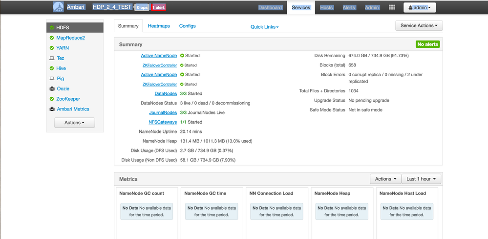

Namenode Issue Active and Standby issue in ambari 2.2
After enabling HA in hdp 2.4.2.0-258 status is showing active.
PFA.

@Ashnee Sharma
It seems there was issue while electing active namenode as per last checkpoint.
To resolve this take both of the namenode down.
[Note:Before this you want to make sure which namenode has latest metadata.]
Start on of the namenode and make sure its performing fine. Then start the other namenode.
Let me know if the resolves the issue.

Super Guru
@Ashnee Sharma
This solution is works for me. Thanks for the immediate reply.
@Ashnee Sharma
It seems like either one of the nodes is not updated with the correct status. Try restarting one of the Namenodes and check.
Hope this helps.
