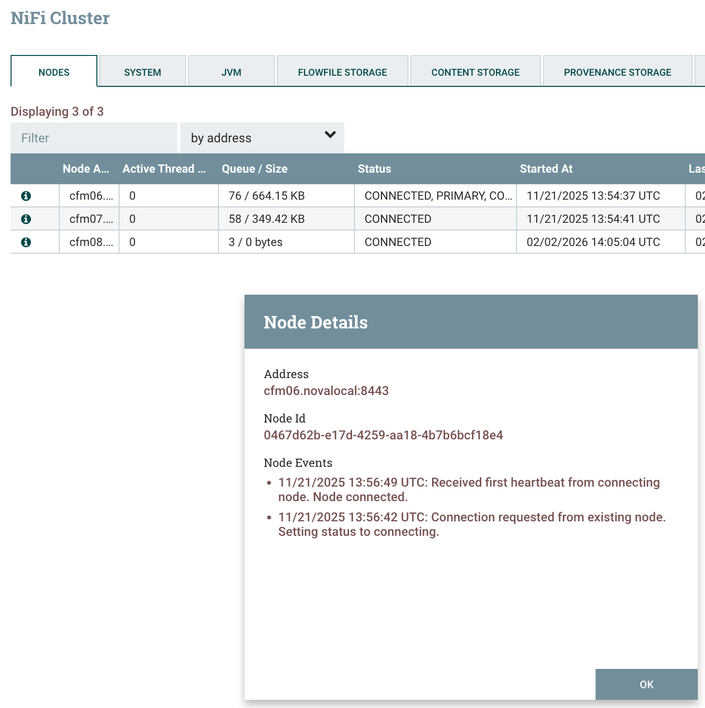

If your NiFi nodes are disconnecting and reconnecting, I would start by looking at the status of the nodes to see what reason is being given for the disconnects.   You can find this in the Cluster UI within NiFi:
Clicking on the small "i" icon to the left of the node name will open the pop-up window above that shows node events.  You should also see node events in the nifi-app.logs on each node.
