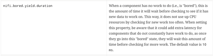

To adjust this setting, you can change the following property in the nifi.properties file:
nifi.bored.yield.duration found in Core Properties section of admin guide.
Keep in mind that this setting impacts all processors.  So higher you set the more latency that could exist before new work is found after a run that resulted in no work.
