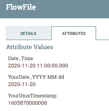

You can do this with UpdateAttribute.
In my example:
Date_Time ==> ${YourUnixTimestamp:toDate():format('YYYY-MM-dd hh:mm:ss.SSS', 'UTC')}
YourDate_YYYY-MM-dd ==>  ${YourUnixTimestamp:toDate():format('YYYY-MM-dd')}
You can check the result here: https://www.unixtimestamp.com/index.php
But you have to remove the last three digits of the value.
Hope this helps!
