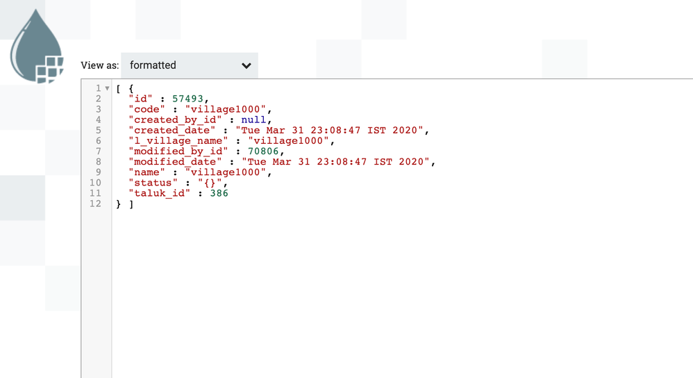

Hi @waltervos , I need to achieve this data conversion in updateAttribute processor. Below are my configuration in updateAttribure.
PropertyName: created_date
Value as : ${created_date.value:toDate("EEE MMM dd HH:mm:ss z yyyy"):toNumber():format("yyyy-MM-dd HH:mm:ss.SSS")}
After updateAttribute I have AttributesToJSON processor -> PutDatabaseRecord.
I am not getting the converted value after updateAttribute or AttributesToJSON. Please suggest how to get the updated value in PutDatabaseRecord. Input JSON attached.

Why do you have toNumber() in there, @skiganesh ?

HI @waltervos , Yes, it worked without converting it to Number also, I was applying the solutions from another post.

Hi @waltervos , I am not getting date converted in updateAttribute processor. Please suggest.
