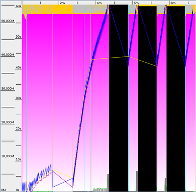

UPDATE I've played a little bit with GC1 using Oracle documentation. I still do not have a definitive solution. I settled to the default configuration, modifying the region size accordingly to the heap (54GB, 30MB region size). I tried to better understand the problem and obtained a detailed picture of the heap using GCViewer. That's the associated heap chart after three consecutive full GCs:

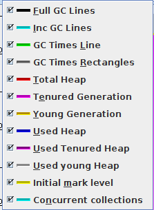

A little bit of explanation for the output if you have not played with GCViewer:

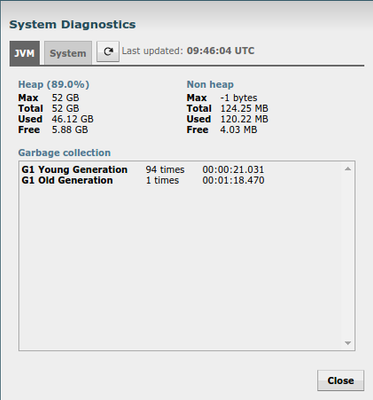

It looks to me that the issue is in that the tenured heap: while the young heap is constantly cleaned in the GC young cycles (the grey line oscillating at the top of the picture), the tenured heap is used but never cleaned up. Some questions: Could it be a viable option to triggering more mixed GCs? How do I obtain that using the configuration parameters? Should I switch to the old CMS GC even if it proved itself to be not that good on huge heaps? Any suggestion is really appreciated. Thank you _________________________________________________________________________________________________ Hello everybody, I am developing a flow which requires good performances. It is running on a single instance with 16 cores and 64GB memory. I've configured NiFi to use 54GB of them with the G1 garbage collector. I am currently facing this memory issue: with a fresh NiFi start, all processors running but no input, it uses 1GB. I get some input in (1.5GB), the flow starts, consumes all the data and ends the computation without triggering any full GC. Tracking the memory using the system diagnostic page, I can see that it is constantly eating memory, at the point that only 2-3 free GB are left when no input is left in the flow. No space is released after that.
I would expect that that's the most memory it needs to consume that input data, but if I try to get the same input size back in, it basically does not release any memory, in fact it continues eating it until full GCs are triggered. It takes really too much time to complete them, that's a screenshot of the system diagnostic page after the first one is triggered:
Is this a normal behavior for the JVM? Is there a way I can avoid triggering full GCs?

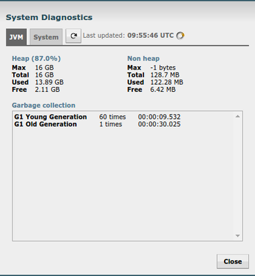

I've also tried to reduce the assigned heap down to 16GB. Full GCs are quicker, but more frequent as I expected.
