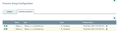

Hello,
While I was trying to setup the HBase Client Service (disabling and enabling a few times, to edit the properties), I now see the service is stuck in "Disabling" state; when I select the only option that is now available, "Remove", it would not let me delete it, it says "cannot be deleted because it is not disabled"; I tried creating a second Client Service, but that too ended up in the same situation.
What I noticed is, even when enabling it, it never went to the "Enabled" state, it was showing "Enabling" for state.

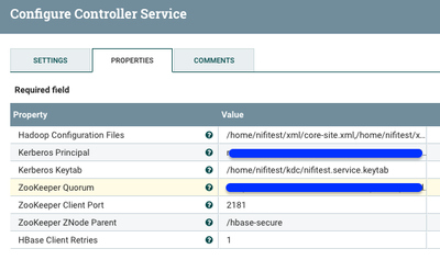

Our HDP environment is Kerberized, and so I did provide the necessary information in the properties for HBase Client service. Initially, I did not supply the ZooKepper info, because the documentation says it's required only if the Hadoop Configuration Files are not supplied. But when it was showing an error ("The node /hbase is not in ZooKeeper. It should have been written by the master. Check the value configured in 'zookeeper.znode.parent'. There could be a mismatch with the one configured in the master."), I added the ZooKepper info in the properties.
As a side note, PutHDFS works perfectly fine with the same Hadoop Configuration Files, Principal, and Keytab;
Please suggest how to make this work, thanks.

It turned out that I was missing hbase-site.xml in the Hadoop configuration files, which I added; now the log shows a different error - "Failed to invoke @OnEnabled method due to java.io.IOException: java.lang.reflect.InvocationTargetException" ; it does not seem to be a login issue, because it says successfully logged in.
