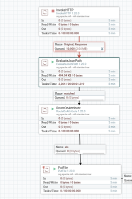

Hey there,

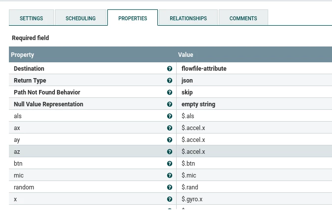

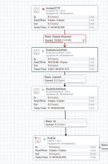

I need some help with configuring EvaluateJsonpath because I'm having trouble with it. Everything else seems to be working fine, but I always get stuck at this part. I've tried looking for solutions online, but none of them seem to work or they're just outdated. It's possible that I messed up something in the other function blocks, but they still work if I remove the EvaluateJsonpath. Any ideas?

What you are doing is mostly correct.  I see a couple of items that may be creating some issues, e.g. mis-assigned values.
For example, you are assigning accel.x to all three attributes values ax, ay, az.  But it seems like you probably meant to assign ax = $.accel.x , ay =$.accel.y , az =$.accel.z
It seems you've mixed up "random" and "rand".  The field name in your JSON is "random" so your attribute assignment should be rand = $.random
Where is "btn" in your JSON?
