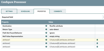

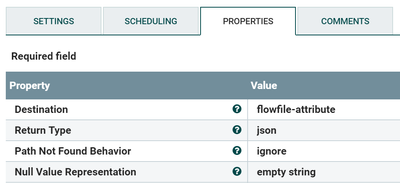

EvaluateJSONpath:
Where i add properties for each attribute i want to parse:
attribute1: $.features[0].attributes.attribute1 etc. etc.

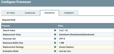

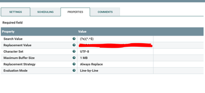

ReplaceText:
I think something goes wrong in my configuration here, because even before the MergeContent the single CSVs created per JSON file contain hundreds of duplicate rows, whereas it should be just one row per CSV that they are gonna be later merged into a big CSV file.

I suspect duplicates are from Replace Text processor you have configured
Evaluation Mode
Line-by-Line
That means let's take the your json having more than 1 new line, Replace text processor is going to be Replace the whole line with
Replacement Value
${attribute1}${attribute2}${attribute3}

Replace Text Configs:-

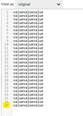

Output:-
As output we got 27 lines because we are having evaluation mode as line by line.

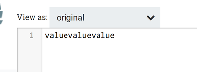

If you change the Evaluation mode to Entire text then
Output:-
And you are having json message in one line i.e
{"features":[{"feature":{"paths":[[[214985.27600000054,427573.33100000024],[215011.98900000006,427568.84200000018],[215035.35300000012,427565.00499999896],[215128.48900000006,427549.4290000014],[215134.43699999899,427548.65599999949],[215150.86800000072,427546.87900000066],[215179.33199999854,427544.19799999893]]]},"attributes":{"attribute1":"value","attribute2":"value","attribute3":"value","attribute4":"value",}}]}
Then if you keep replace text configs as line by line or entire text it doesn't matter because we are having just one line as input to the processor and we will get result from replace text as
Try to change the configs as per your Input Json Message and run again the processor.
Let us know if the processor still resulting duplicate data.

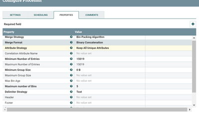

Hi @Shu yes that was exactly the problem, now the individual CSVs are created just fine but in the meantime another problem occured. When the individual CSVs are merged with the MergedContent processor then the Merged CSV is all in one line instead of seperate lines. Is there a way to bypass this?
MergeContent:
Master Guru
@balalaika
For that case you need to specify Demarcator property as
Shift+enter
Configs:-
For merge content reference
https://community.hortonworks.com/questions/149047/nifi-how-to-handle-with-mergecontent-processor.ht...
