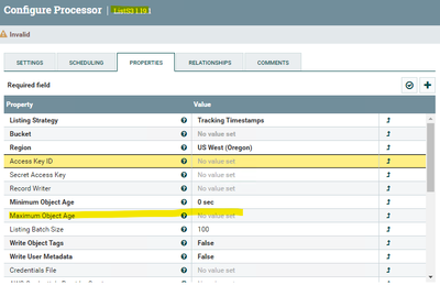

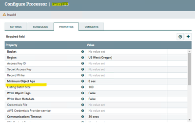

hi @acasta,
What NiFi version do you have? Using 1.19.1, within List S3, the Maximum Object Age is present and is in the 8th Property from top to bottom. However, when using 1.15.3, that property is not present at all. So the reason for you not seeing it is most likely your NiFi Version.
1.19.1:
1.15.3
From my point of view, you have two options here:
- You either upgrade your NiFi Instance to a newer version.
- If you have something in your Tags that you could use you to filter your data, you could set Write Object Tags to True and afterwards use an RouteOnAttribute Processor to filter out your data.
