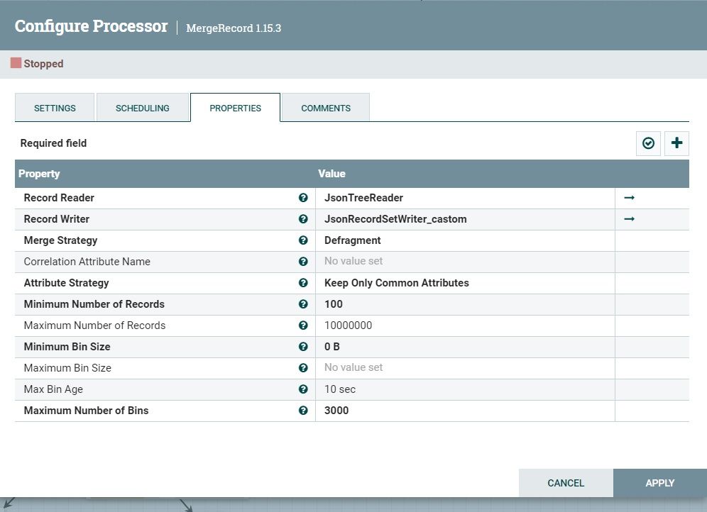

222.jpg333.jpgThanks for the hint on the schema. I am using JsonTreeReader and JsonRecordSetWriter as standard. What schema options can be used to make MergeRecord work?
Well first of all, how does the data look like before entering MergeRecord?
Secondly, how did you configure both the Reader and the Writer? You pasted the configuration for MergeRecord, where this has nothing to do with how the data gets transformed.

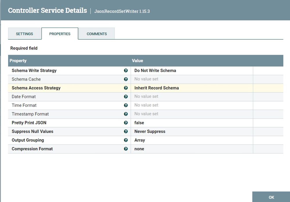

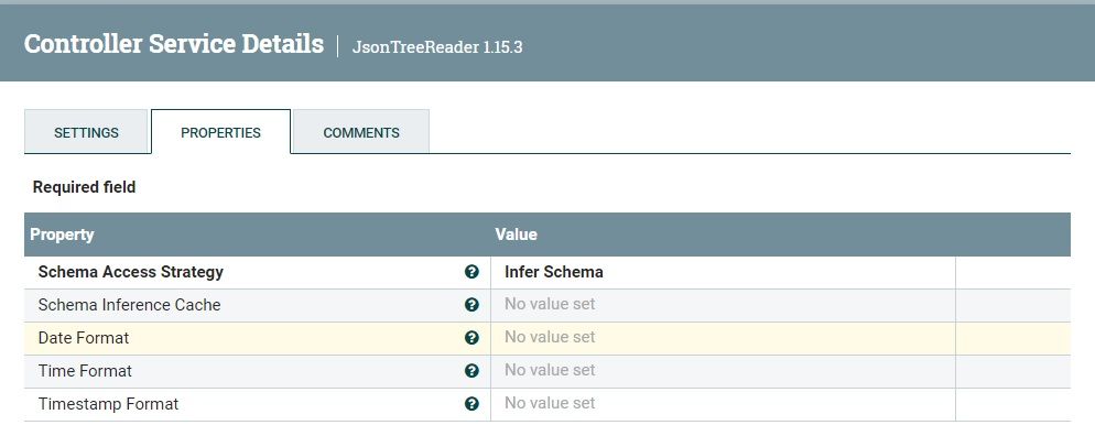

Reader
 Writer
Well I am not near a PC to test right now, but my initial thoughts are that the problem is related to how your raw data is coming in your flow.
As I can see, you have both an INT value and a FLOAT Value .... and not a constant data type:
"stake" : 0,
"stake" : 0.5,
Now, you set your Schema Access Strategy to Inherit Record Schema.This is correct in most cases, but in your case it is not, because your data is not stable.
If two files are going into your MergeRecord and one has the value 0 and one has the value 0,5, you will have two different schemas, meaning that the files cannot be merged accordingly. If the first file comes as an INT, your second flowfile (or all the others coming right after) will automatically be converted to an INT value, no matter their value.
To avoid this, you will have to generate the schema manually and change your RecordReader and your RecordWritter from Inherit Record Schema to "Use Schema Text Property" and define your schema manually in the new field (which will appear upon the switch).
Make sure that in your schema that field is defined with a data type which accepts fractional data and not just an int value.
