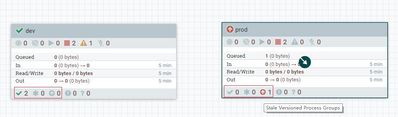

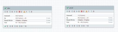

It seems no such function yet. I currently move all my stuff in a 'root' group and version control it. For example, let's assume there are two environments - dev and prod. And I just import the same version-controlled 'root' group twice and named them 'dev' and 'prod'. When 'root' group version changed, all processes and groups inside - including version-controlled groups - changed too.108584-1.jpg
dev has 2 version-controlled groups inside and prod has 1 currently

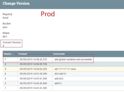

change prod version to 7 to sync

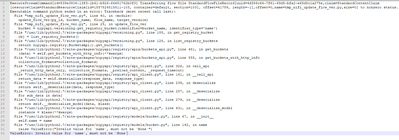

Hi, I was told Python 2.7.5 is already available on my DEV. Installed nipyapi and changed CommandPath in ExecuteStreamCommand. On execution this error happens:
Question: Is it absolutely necessary having Python3.x or can you see another cause for this exception?
Thanks for your help and this solution!

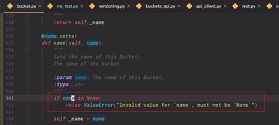

I compared the bucket.py in Python37 (local) and Python275 (DEV-System with Cluster) but there is no difference.
Maybe you could give me a hint to solve this problem? Thanks!

Hi
I tried but I can't reproduce it:
# 1. set identifier to None
nipyapi.versioning.get_registry_bucket(identifier=None, identifier_type='name')
# return: TypeError: 'in <string>' requires string as left operand, not NoneType
# 2. empty all bucket in nifi-registry and try to get bucket
nipyapi.versioning.get_registry_bucket(identifier='test', identifier_type='name')
# return: None
I can't reach the code in quote:
1. If nifi-registry has buckets, each bucket's name will set to this 'name' parameter and can not be None at all.
2. If nifi-registry is empty(no bucket), the code won't be executed (because return a empty list)
My suggestions:
1. check `nipyapi.config.registry_config.host = 'http://your-server:18080/nifi-registry-api'`
2. try to use a new nifi-registry and run the code again to find out whether the error occurs. (I recommand using docker: https://hub.docker.com/r/apache/nifi-registry )
3. it seems python version is not the problem here.
